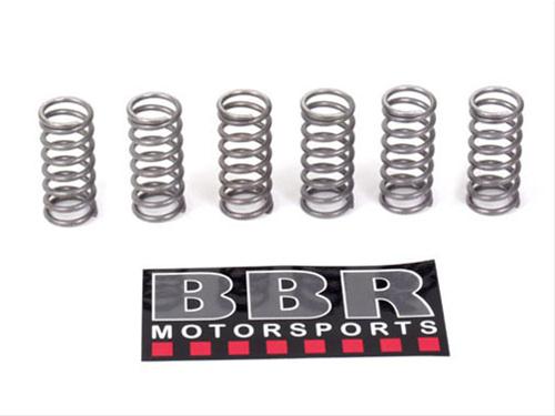

i just finished my clutch job on my z125. first all you dont have to reuse 2 of the plates like others have done you can use all the plates from your kit.
the part numbers are
tbparts #1035 (KAWASAKI KLX110 KLX110L Heavy Duty Clutch Kit Plates Springs 2002-2016)
this kit comes with the hd springs and they are very stiff but if you like softer springs go with the bbr springs (410-KLX-1105)
now for my review no slip anywhere very consistent feel and grab so for those of you who want a clutch and dont know what to get here is what i used but im sure any klx 110 kit will work just fine aswell and lik ei said you dont need to reuse the old junk. enjoy

it depends on the springs your using on how hard its gonna grab. on mine at first it was right off the bar and as it set in it ended up being a little before half way but the engagment is allot firmer and will give better feedback. i hope this helps you.
