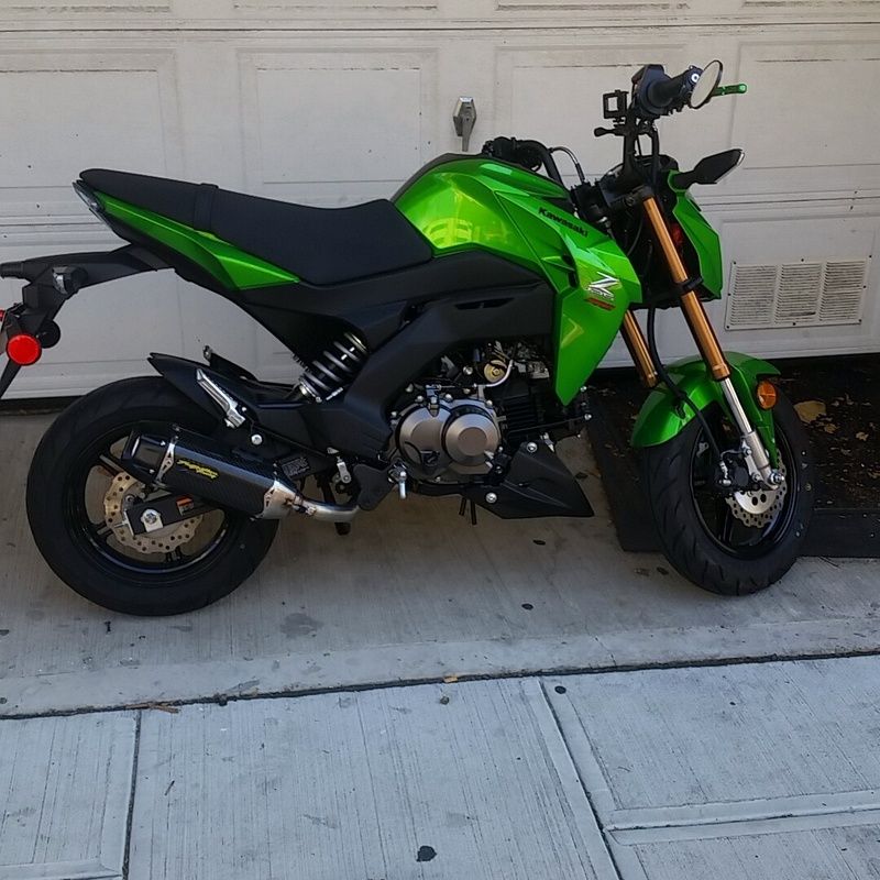

Just finished installing my new exhaust! Pretty straightforward install, definitely leave everything loose and take your time to get it mounted flush and remember to use anti-seize. Haven't removed the dB killer yet as all I have at home are cheap tools but I like the subtle sound of it. Picked it up at $350 shipped and am definitely satisfied thus far. No sound clips yet but here's a pic!

Ok that's what I thought.. I'm used to calling it a silencer! Lol, looks good Jetta post back how you like the sound when you take it for a ride I'm curious because I'm leaning towards the two brothers even though the m4 has me curious

I love my two bros. It sounds awesome. I still want to pull the db killer and ride it to see how it sounds on the road instead of idle. Looks and sounds good. I got mine for $370 shipped. I couldnt pass that deal up. Im happy with it.
