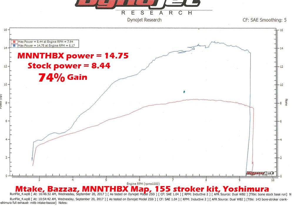

Knowing this bike was wicked fast, we had the chance to get it on the dyno today before turning it back over to Kawasaki. The numbers would be a bit better, but this motor has 8 miles on it, so it will be a while before it loosens up. It was compared to a stock 900 mile bike, with the dyno pulls 5 minutes apart. Regardless, it's an easy, reliable runner!
