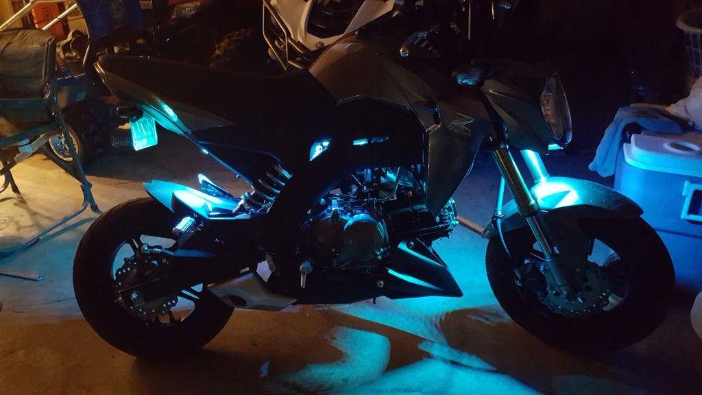

Here are my lights I installed today. Very simple and cheap. Also a picture of my license plate bracket I made for free with just the parts that were already there. No welding. Did mount the stock light right to my plate tho.
Here is the link to the lights:EJ's SUPER CAR 4pc. Color 7 Color LED Car Interior Lighting Kit,car interior decoration atmosphere light and Wireless Remote Control https://www.amazon.com/dp/B01KVZ5DIC/ref=cm_sw_r_cp_apa_sQvwzbPS8ZK1D

I removed my whole rear assembly. The license plate bracket unbolted from the plastic fender. That bracket is actually 2 pieces. The smaller piece matches up with 2 of the original mounting holes under the tail section on the bike. I drilled out the threads on the small bracket so I could use longer bolts and screw back into the bike itself. The plate was angled to much to see. I used a pair of channel locks to bend each side in till you can see the plate. I actually mounted the original license plate light right to the plate. It cost me 2 longer bolts. I wish I still had the stock parts to show pics, but I will post some of what it looks like installed
The bracket holding my plate is actually part of the original bracket that came on the bike. No cutting or welding. You can see how I had to twist it to get the plate to the correct angle
Mounted the light to the plate and ran the wire back the way it originally was
