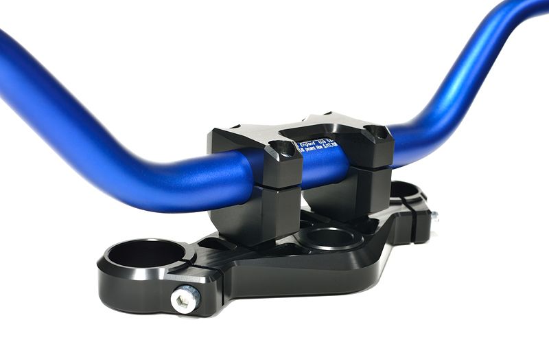

We designed our top clamp & riser to have four mounting positions front to back to allow you to tailor the position to your tastes. Being 6'2", I personally wanted the ability to get the bars out of my knees...

We've made Z top clamps and bar mounts for oversized bars forever, and they're awesome. Adjustable to four positions front to back. Bars are a matter of personal taste, but the RC High is so a popular end, it's now the only one we stock. Hard to beat....
