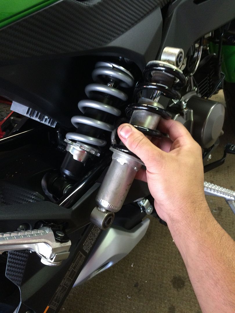

but my friend brought over his stock grom shock, and from only looking it seems the same as the z125
Now the z125 stock shock is larger is diameter, but length and connections look similar to the grom
Which MAY mean grom aftermarket MAY work
Since there are quite a few grom shocks out there it may be one of those things others will have to verify
as I really don't see purchasing a grom shock yet....
I would like to lower the rear a couple inches so if I do find a lower grom shock I may get one

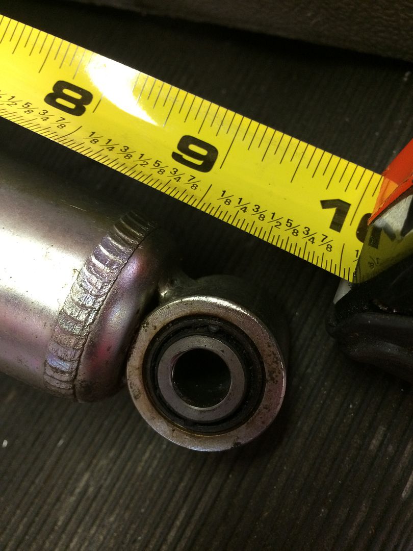

anyways I measured the grom shock
next time I have my body panels off which will be soon I can confirm the stock z shock length
overall length, outside to outside almost 10 3/4
looks same length
EYE to EYE 9-1/2
if anyone else has mounted a grom shock, please post which brand, and if it lowered or raised the height of the bike
So far I'm satisfied with the stock
but would like a way to lower the bike a few inches
