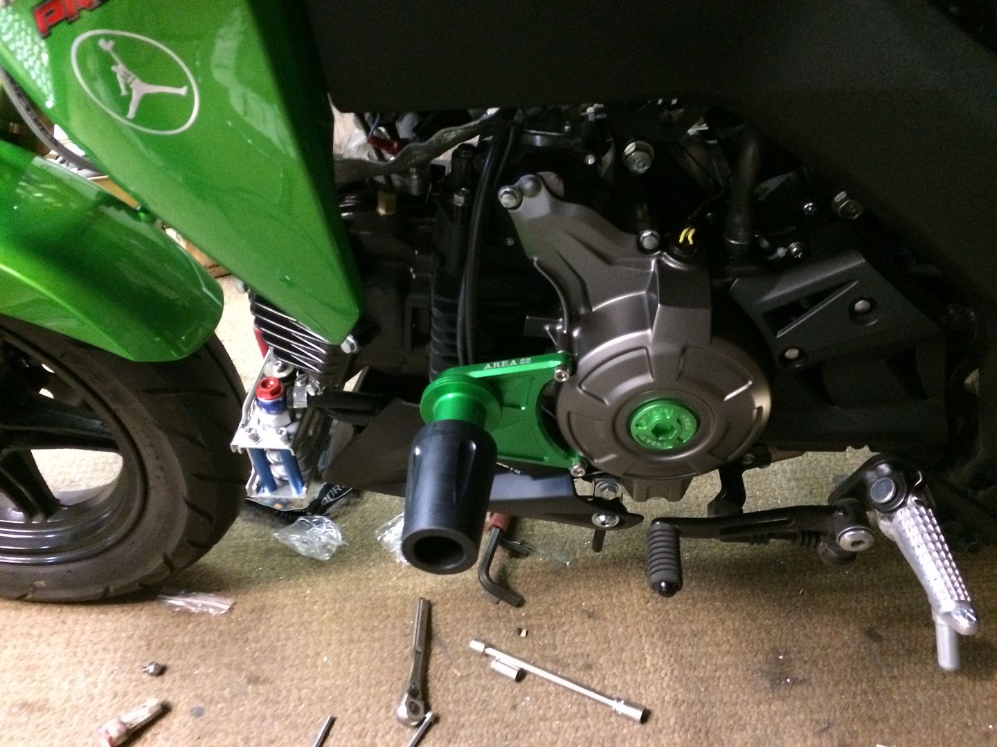

I bought some area 22 frame sliders
Its hard to judge how they really look on the website
so I took a gamble
Ordered sunday, came today
From canada!!
thats pretty quick
anyways first glance they are huge
but whatever I can deal with that
The green is little darker then the other area 22 items I have purchased, but maybe they will fade a little over time
No instructions so had to figure out where all the bolts and spacers went
First problem
the right side mount didnt fit flat, and scratched the paint on my engine
the mount uses spacers, to hold off the engine so I was pretty surprised it hit and scratched
I had to dremmel heavily in the nice dent marks that was on the aluminum, since it hit my engine it left the impression on where to grind away
Took a few tries to get it right, the photos I will post won't show the final grinding as it takes a lot to get it on to see if it hits
and once on I didnt want to remove to take photos
The left side bracket fit perfectly
Also one other issue that really bothers me, at least for right now
they are not level, or even with each other
Now I've had frame sliders on other bikes in the past, pretty sure they were even
but they were much wider so who knows
I would think someone had took the time to make these mounts, why not spend the extra time to level them out with each other
As you will see in the photos the left side is farther forward then the right
I think moving the right out forward more may be better so you don't risk your shoe hitting the slider
Probably no one will ever see how they are not even
but I will, and right now bothers me
For almost $100 and precision CNC made parts I sort of expect perfect fitment, and alignment

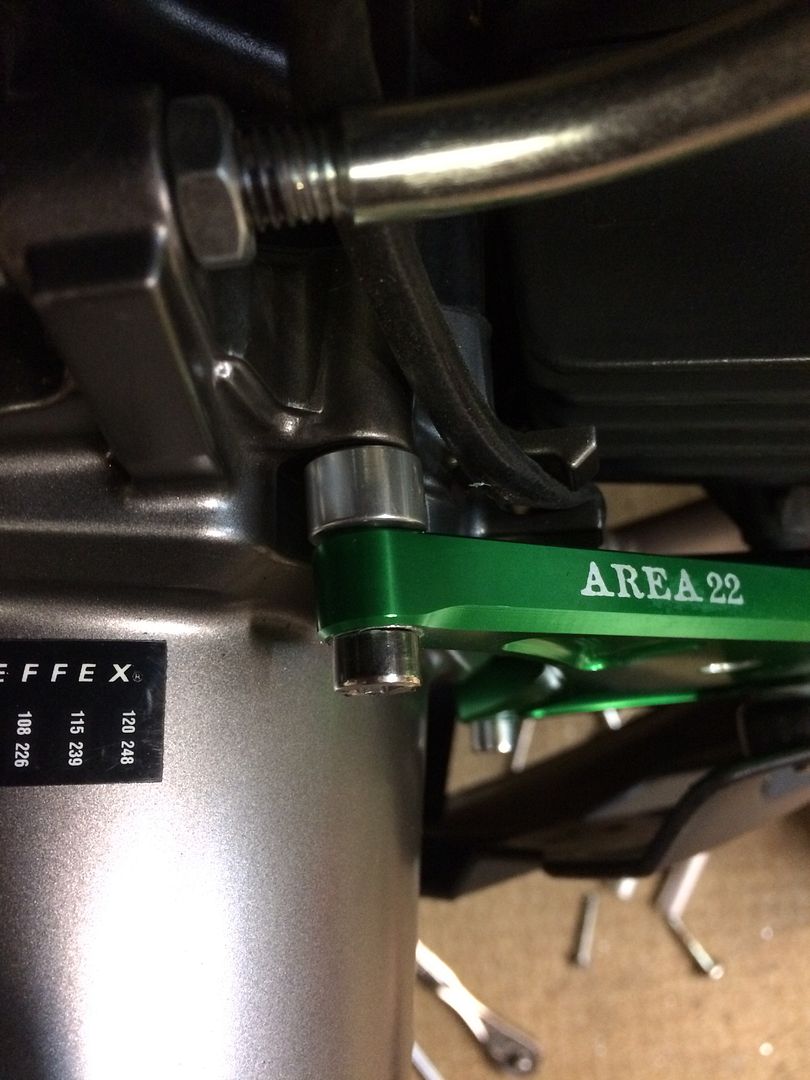

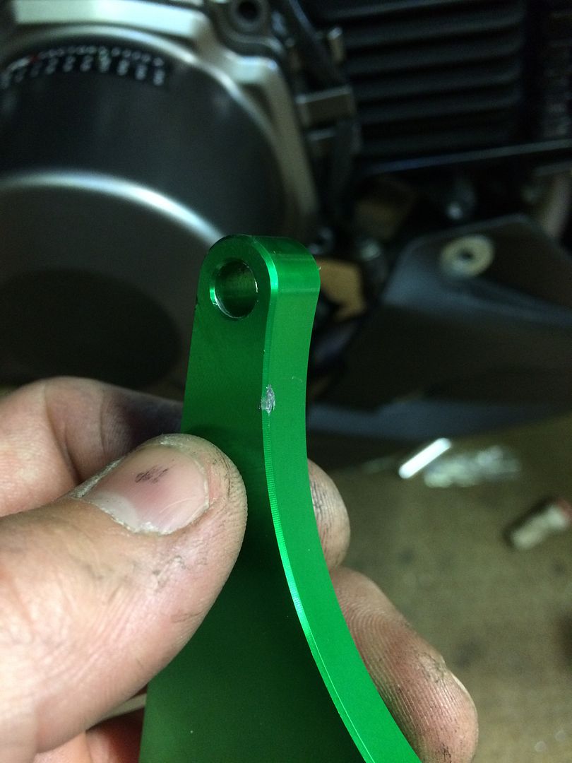

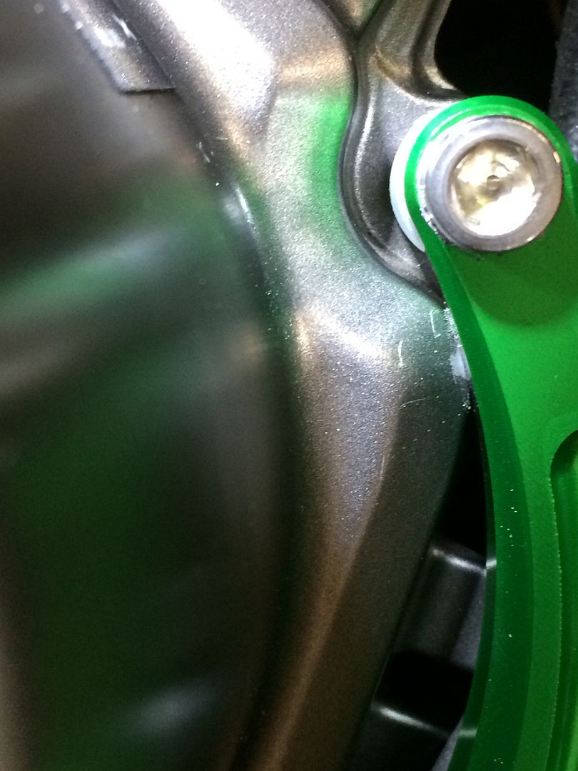

This photos shows how the right side aluminum hits the engine so much its bending the bolt
it also does not sit flush on the provided spacers, I didnt want to risk bending the bolt anymore by tightening it down so thats why I decided to remove some aluminum on the mount to fit flatter

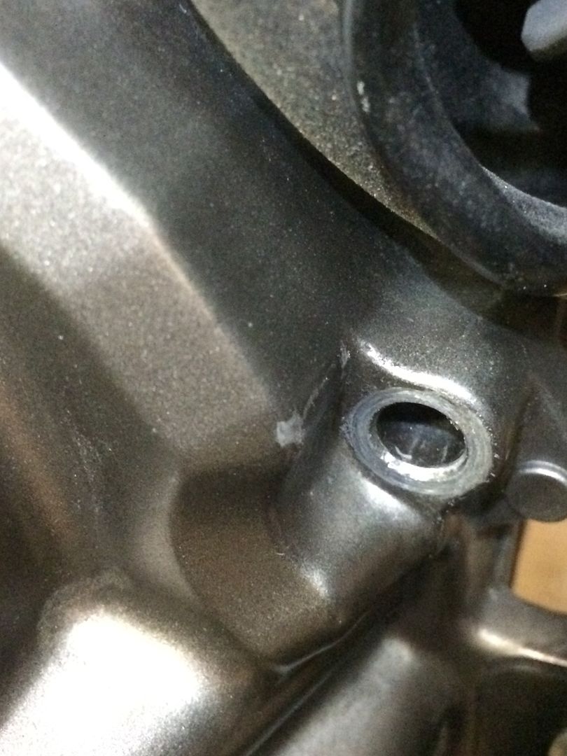

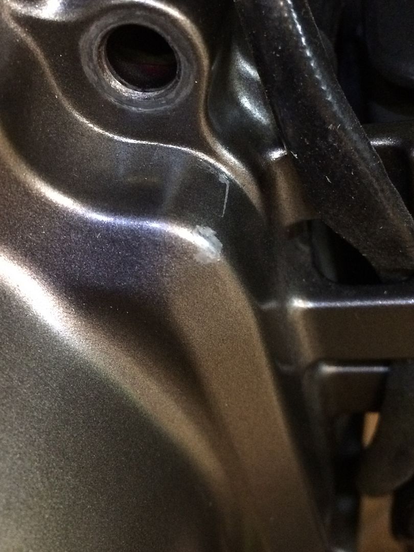

Here are the scratches it left

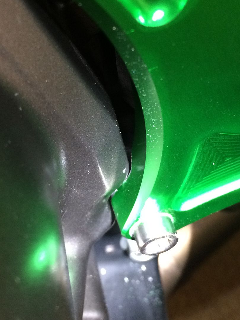

the beginning of the spot it hit my engine
Sensitive content, not recommended for those under 18
Show Content

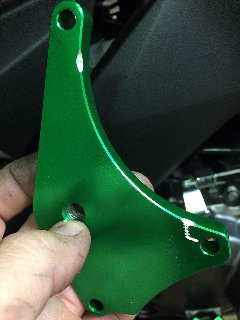

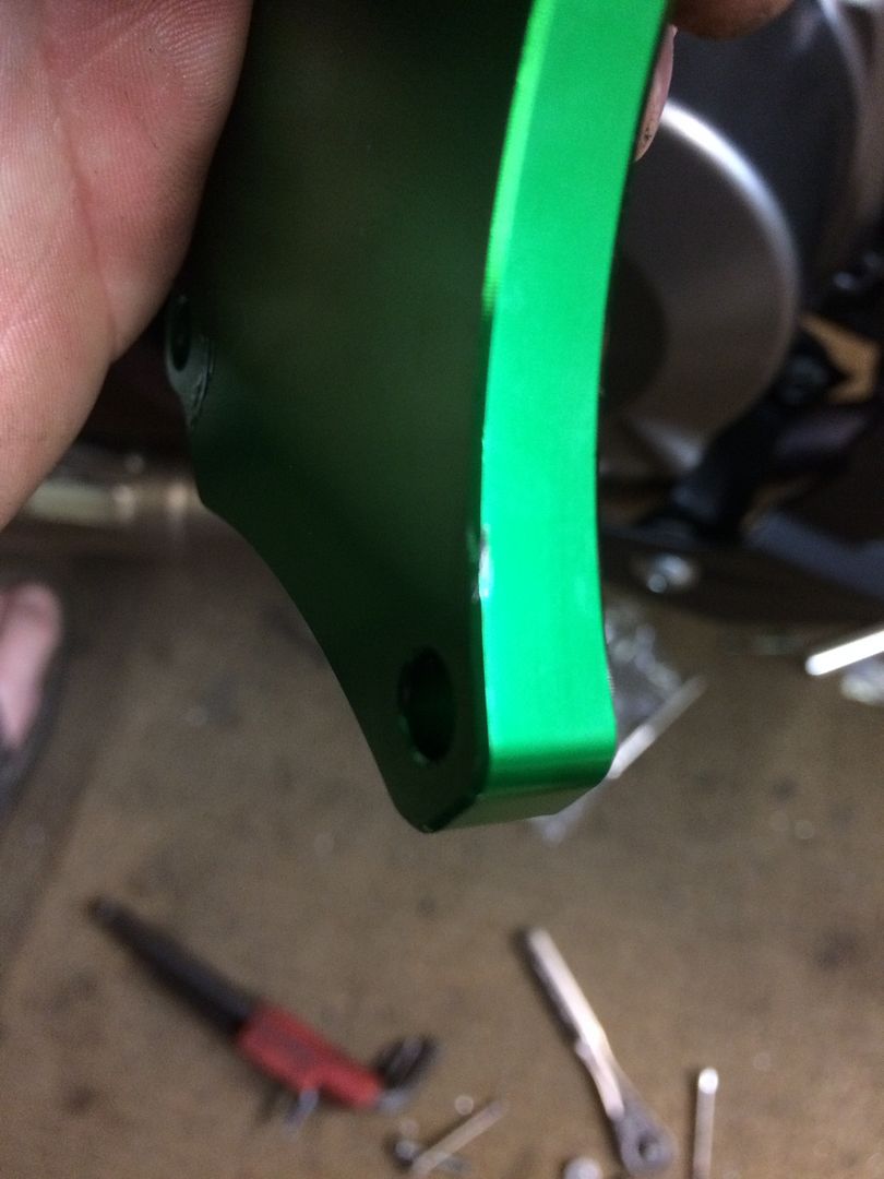

beginning of grinding
in the end I had to do around 3x the size you see to fit, I did not take photos of the finished product

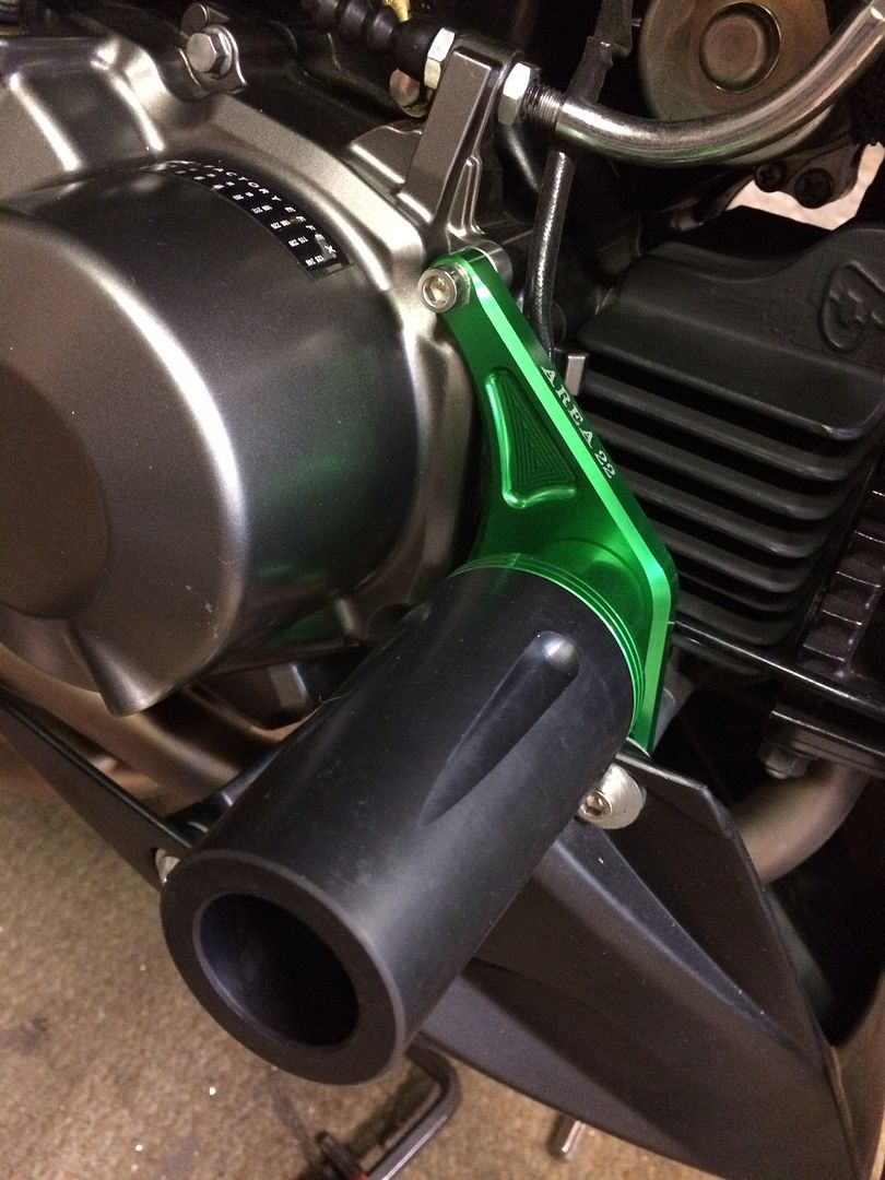

left side fit perfectly (note I had the green spacer behind the slider on the wrong way on the left side photos, this does not change how far it mounted just how it looks, later in the photos it was fixed)
2 bolts right to the engine cover, and one long bolt with solid spacer to the engine itself
the right side had 2 bolts to the engine cover, with short spacers to keep the aluminum off the engine cover
and one long bolt to the plastic undercowl mount with spacer

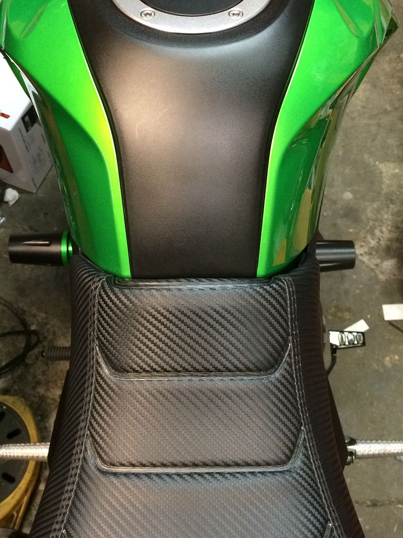

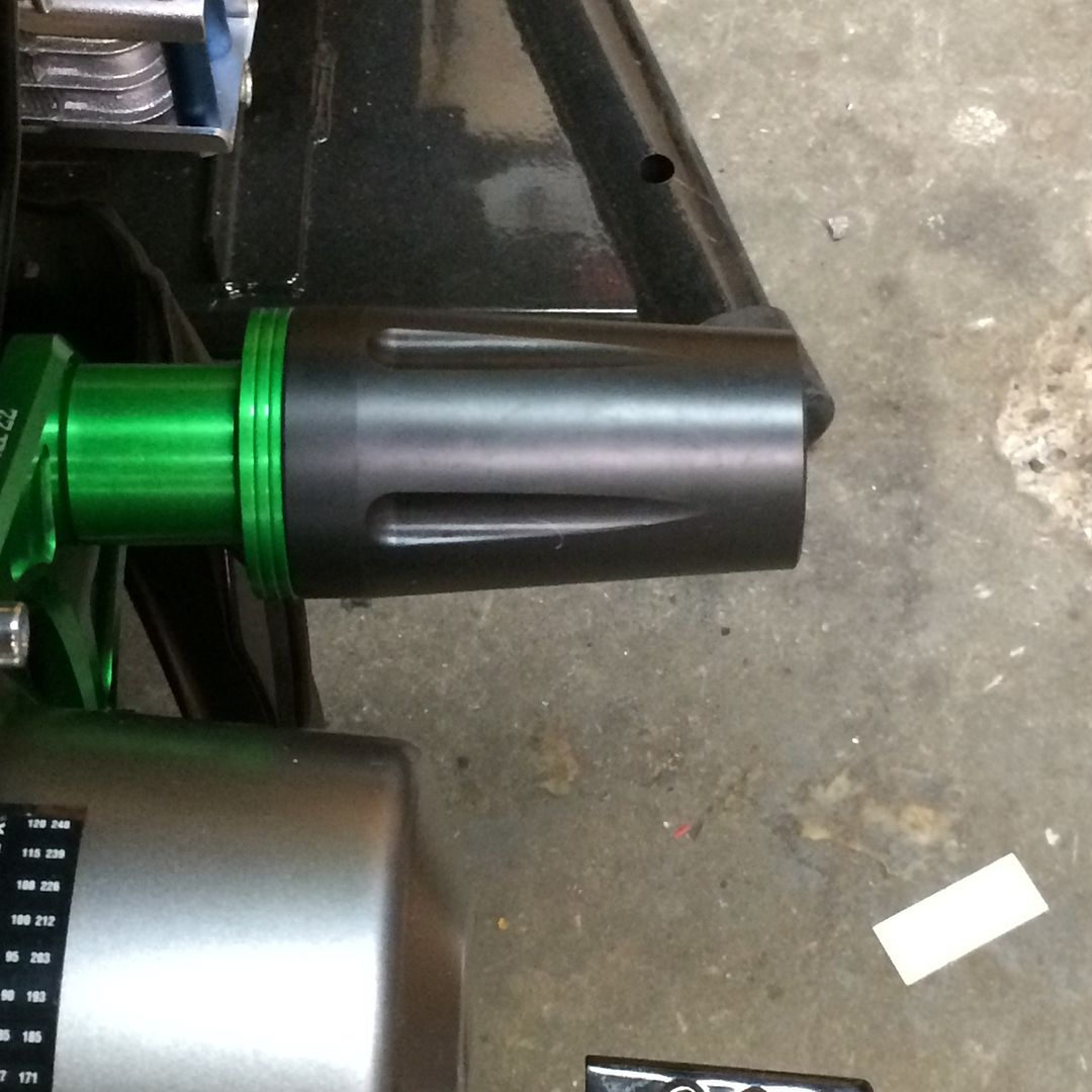

this photo, they look same height but they are off slightly left side is a touch higher
although the left side does look stick out further
to me thats not an issue
the plastic sliders are different lengths and I put the shortest one on the left side, in the photos the left looks to stick out a little further but im cool with that
I think an easy fix for where it hits the right side engine
use slightly longer spacers
and would also need longer bolts
as for them not lining up with each other
unless there is a solid reason why they can't, if some engine part is in the way I would go back to the drawing board and have them look at fixing that issue

Still debating on weather or not I like them, not really happy with the fit
and how large they ended up being
but I need to get a better look at everything in the daylight and get a few rides with them, make sure my foot won't hit the right side one
I agree too they may not help much in a crash
I've seen some on bikes that could also cause more damage when crashed but then those bikes are much heavier
at least the z is pretty light
I only plan on these helping if I drop the bike
since I do a lot of work on it with the swingarm stand I've already had it start to slide off so now I velcro the front brake lever to help keep it from rolling
or using my front wheel stand, I keep it parked on that with kickstand up
so its possible it could fall over
trying to get it out of the garage is a hassle too with all the crap in the way while trying to push it out backwards with the handle bars

riding I use my left leg when coming to a stop
I keep hitting the slider with my leg
also the same when backing up
the right one, leg never hits
shoe never hits
the right side is a lot closer to the frame then the left slider
so after great studying of the width I found the left side can be made even if you remove the green spacer all together
the slider goes right onto the mount
but looks weird
so I cut away almost all the spacer, found a shorter bolt and now at least the width looks much better
and almost even
the height is still different, but that can't be fixed without a new mount made
if you look at the before images use the pegs as reference to the width of the sliders
side note, looks like it would barely protect the exhaust

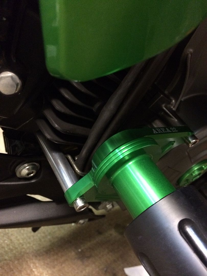

here is the modified one use the foot pegs as reference
so the entire spacer you see, is whats making it stick out a hair past the peg
but it didnt look right with it totally removed so thats why I cut it down very short, just as a trim piece so it somewhat matches the other side
if the spacer was totally removed, the slider width would match up perfectly with the other side
now my left leg doesn't hit when stretching it out coming to a stop
outside photos
they really don't look too bad when you can stand far away
this was before I cut down the spacer
