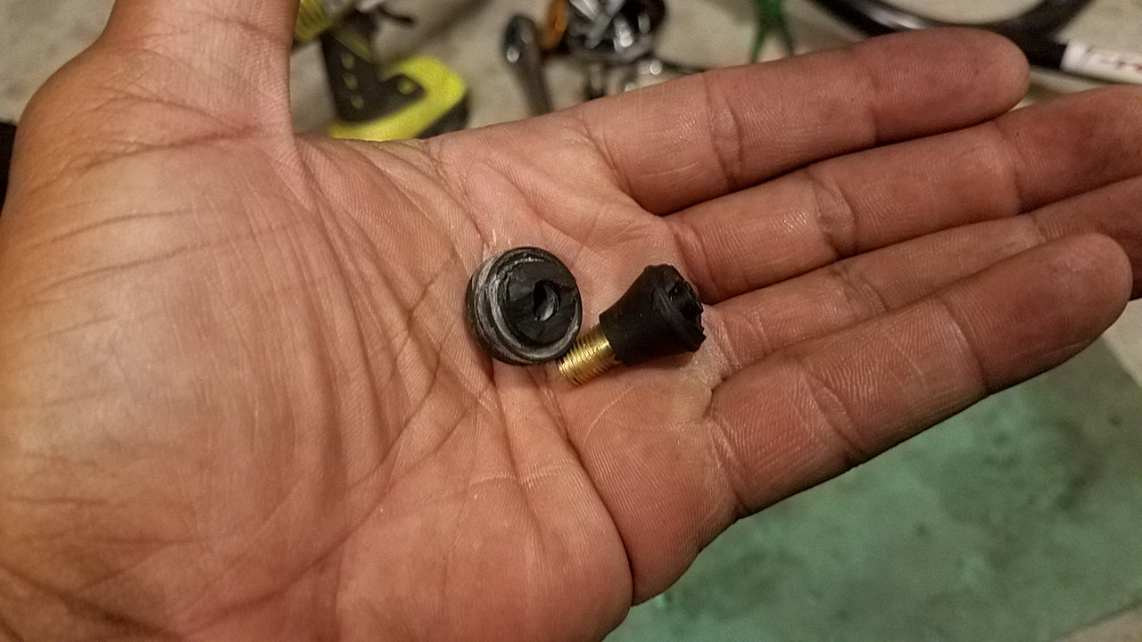

Remove the tire, break the bead near the stem..
With an exacto, cut off the OE stem
Sensitive content, not recommended for those under 18 Show Content
Peel the inner piece out
Leaving this
Two blocks of wood to hold the tire exposing the backside
Wet the rubber on the stem to ease install
Insure fit
After adding a bit of lock-tight, place the nut on the inside of the wheel in position
By hand, screw the angled stem itself on to the nut pulling the stem in place.
Push on the nut to hold it as much as possible to get the stem to seat as far as you can.
Align the stem pointing outwards then hold in place while using a 14mm socket to tighten the nut.
Insure the stem stays pointing outward as you tighten.
Air the tire back up making sure the tire "beads". Check the pressure and check for leaks.
