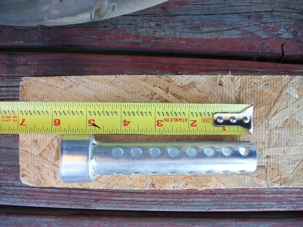

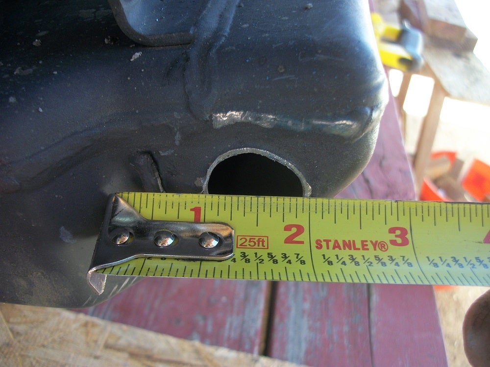

Finally got my 6 dollar baffle from china (5 weeks) but ended up not using it . so it turned out to be a 10 cent muffler mod ! ... $ Hacksaw blade usage plus some rat tail file wear and paint .
If i didn't need a after market pipe for ground clearance issues i would be quite happy with this mod.

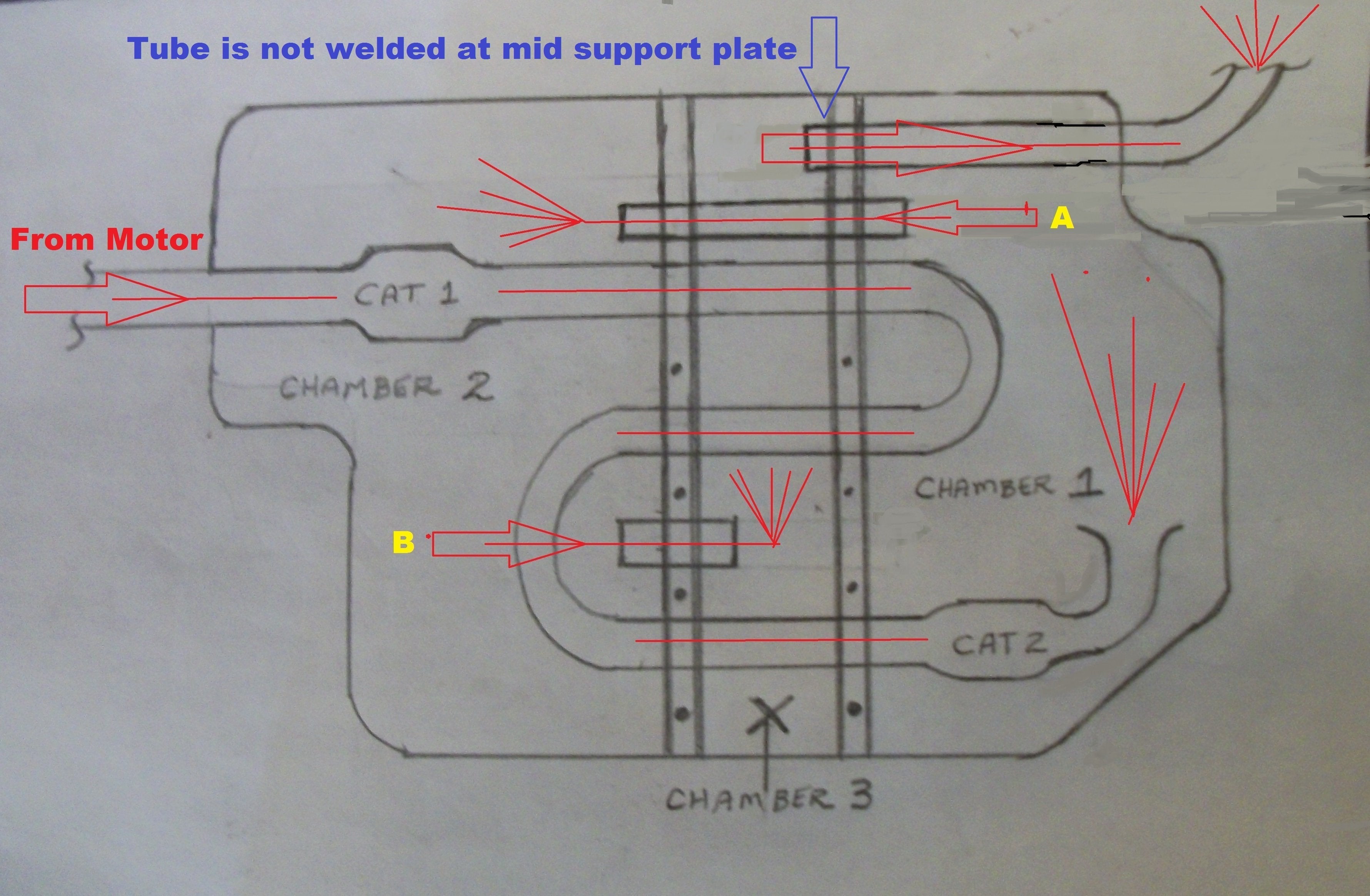

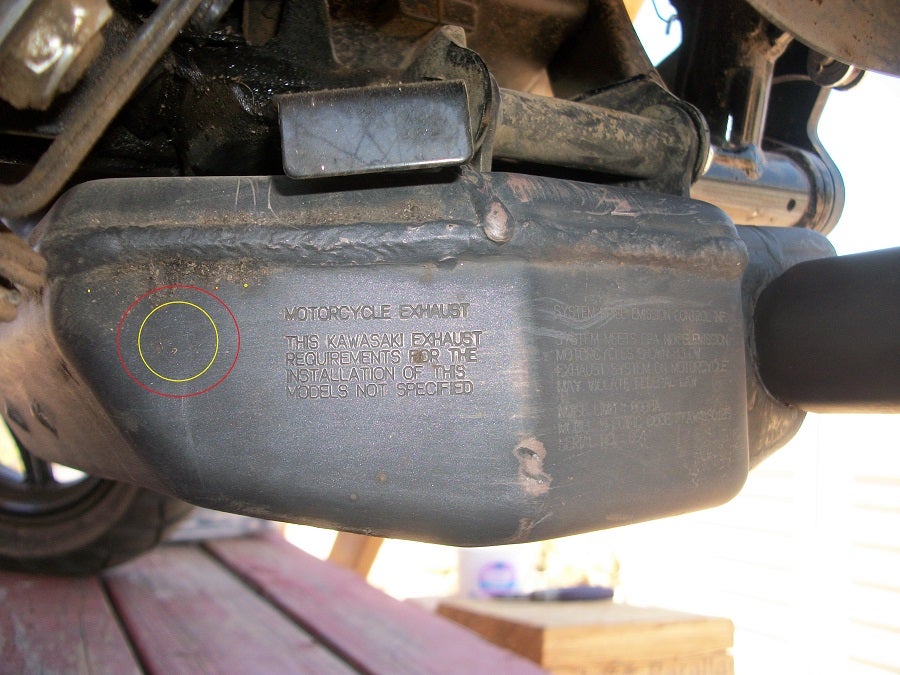

With the stock muffler the exhaust gos into the back chamber #1 and through a cross-tube into chamber #2 then thru another cross-tube into chamber #3 then out the final tube.
so I removed the final tube from chamber #1 and inserted the 1" baffle .so now the exhaust is coming out of chamber #1 for the most part and doesn't have to go through #2 and #3 , but chambers #2 and #3 are still open with the cross-tubes which could also account for the deep tone it puts out now.

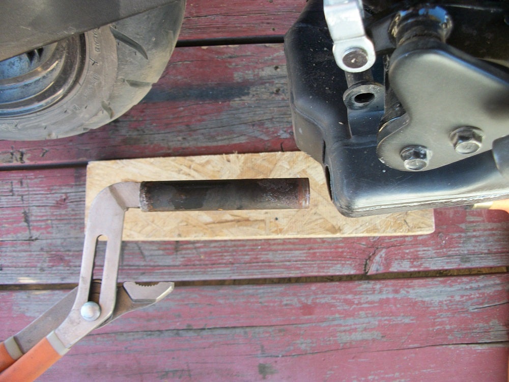

the final tube is not welded at the mid baffle plates , which was a leap of faith i took from the video and sketch i found on you tube (below). It pulled out with a little persuasion , do not let it go back inside or you gonna have one heck of a rattle , pre-load a sharp end set of channel lock pliers in the pipe towards the tire, and tap it out with a hammer .it is snug , but it only took me 5 or 6 hits !
The new sound has about a 20 pre-cent loader sound and a great little deep tone to it.
so great for those just wanting to hide the sewing machine sound .and add a little Va-Room

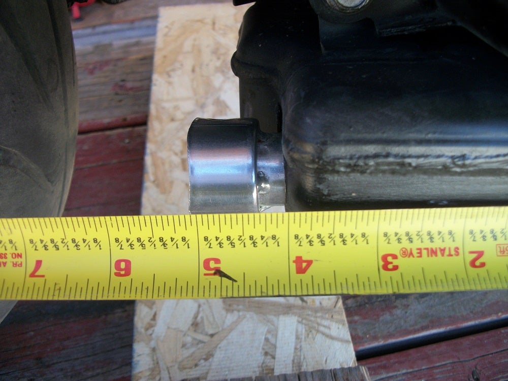

But i also tried it without the baffle with just the 1" hole wide open and no baffle at all, (pic 6 ) and it has about a 40 percent loader sound and a deep tone to it . so going with that set-up myself
Guess you try even a bigger hole if you looking for 100 per-cent loader pipe like the after market ones , but that may or may not work ?
Most of all : It is not a cheesy, lawnmower, want-a-be real pipe sound at all.
Both ways it is a good deep tone just like a 400 dollar pipe / for 10 cents :D

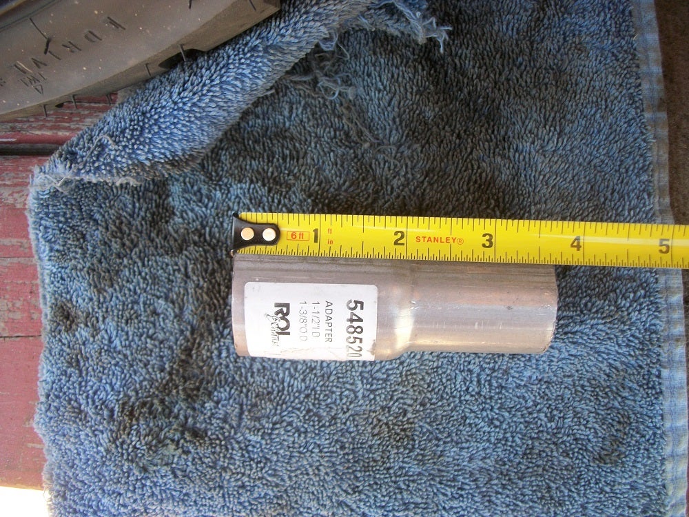

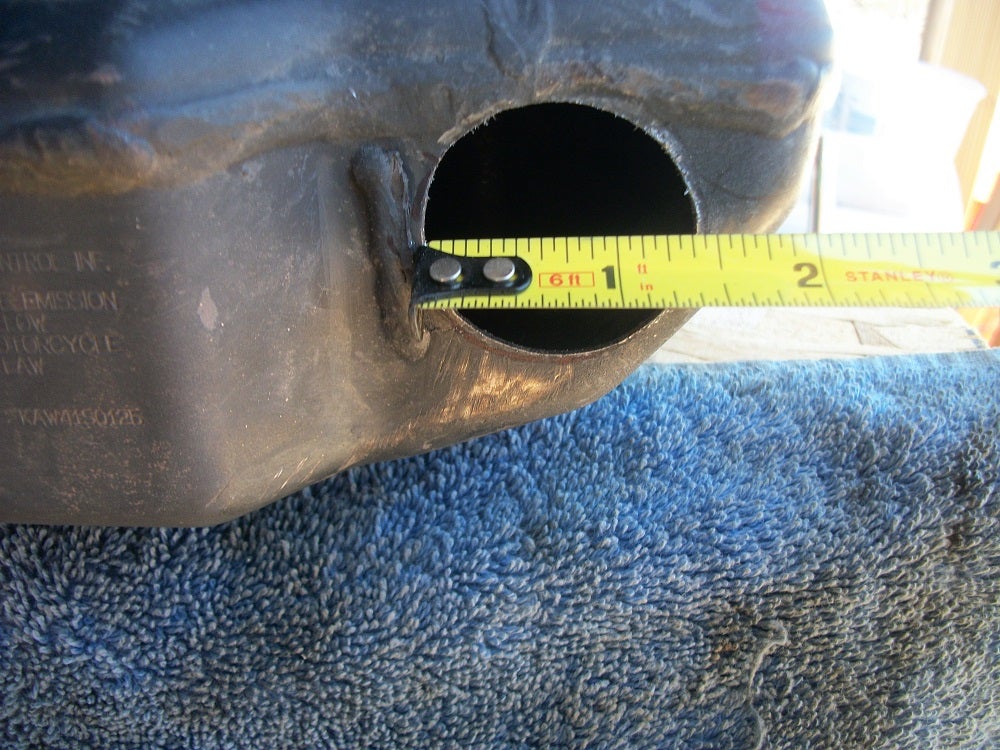

I was going to weld the baffle in at first just so it looked clean and stock , but i need a aftermarket pipe for ground clearance issues . so just running it as is
I also had a 1 1/2" sleeve ready in case the 1" baffle wasn't the sound I wanted , It would probably sound even a little better and louder if some was to try that .:confused:
but the 1" is plenty loud enough for me ...
1 1/2" ID X 1 1/2" OD muffler sleeve from pep boys auto center
and it would weld in nice and look factory .

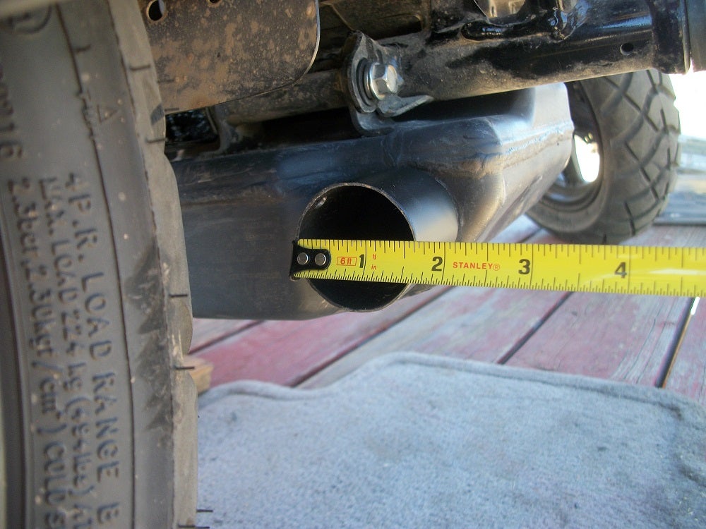

Well , had to go check out what that sounded like .
It lost half of noise and 3/4 of the Growl when i held the stock 3/4 diameter tip back in place
And with the 3/4 tube i took out held in place it almost sounded just like the stock tip above held in place but even a little less.
My 1" baffle i lost 20 per cent of the Growl with the 1" open
And it even loses a little Growl just holding the 1 1/2 tip on the end over the 1" hole.
Looks like any tube extension tip will lose some Growl.
And just leaving the flush 1" hole is the best sound i'm hearing ..
Which was just dumb luck :confused:
